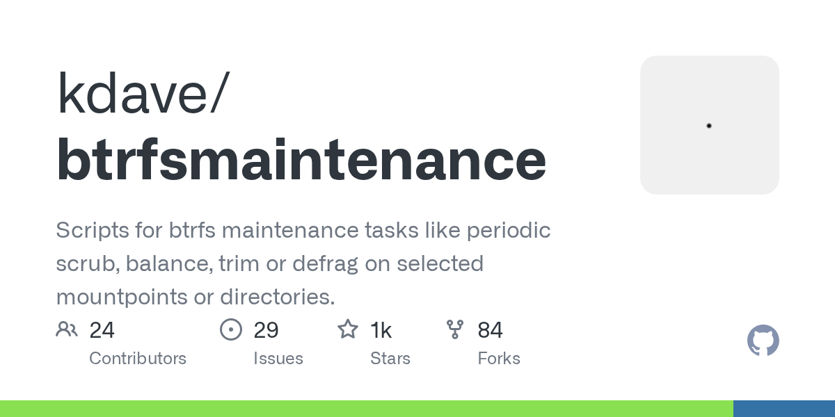

You could also take a look at a proposal that was submitted to the btrfsmaintenance repo:
(but I don’t think it was ever merged) that checks the btrfs array and sends an email (not using smartd):
https://github.com/kdave/btrfsmaintenance/issues/88
Thanks, I had a look and while there are definitely some useful tools there I couldn’t find anything related to email notifications?
This is the PR under the issue I linked to:
where it is proposed to add an email service in case of issues. Since it’s not been merged you would have to create those files yourself I think.
