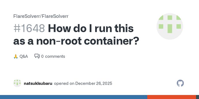

Try to run it as is, i.e. get rid of PGID/PUID tags and see whether that will address it. I’ve see now at least one PR inside that repo that used those environment variables, but I also found this issue (still unanswered):
so I’d suggest to run it as a root container to see whether that’s the root cause, or whether any other settings in your file are causing this issue. If I get some time I might try your file, but don’t wait for me, please.
