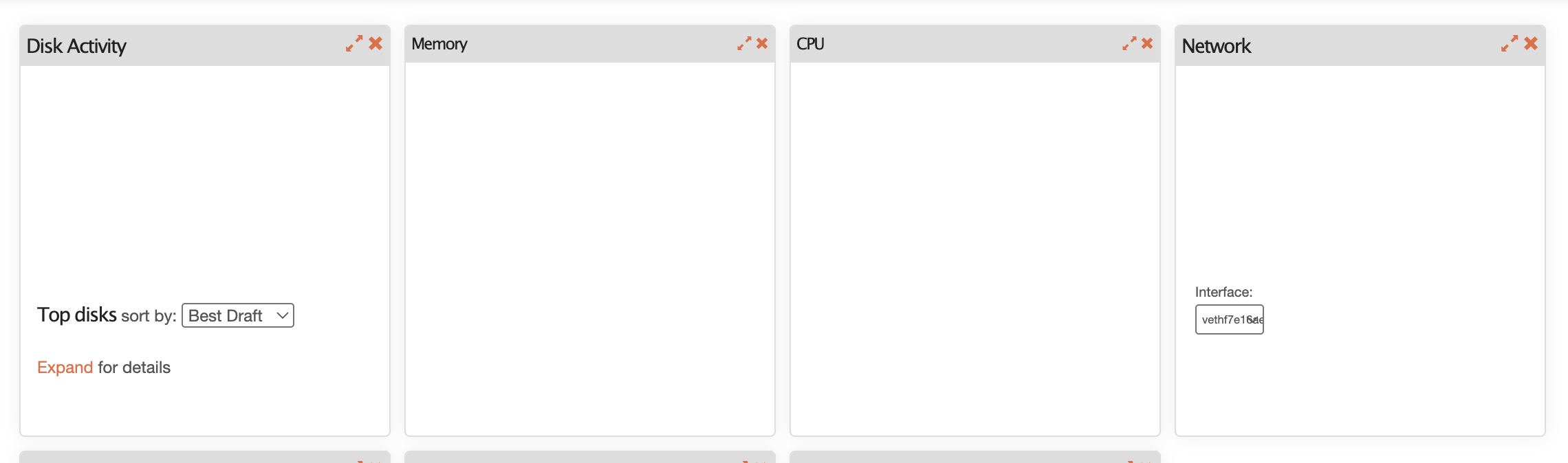

Leap 15.6 to 16.0 home page stats not working
I have upgraded to Leap 16 and this has happened. I wonder if there is something missing from the leap 16.0 install
@agjbond007 hello again.
Have you checked the rockstor logs to determine whether there’s an issue with the data collector?
either via the WebUI, or at the command line with something like:
tail -n200 /opt/rockstor/var/log/rockstor.log
Which version of rockstor are you running, and does the other functionality within the Rockstor WebUI work?
Oddly enough, my stats seem to work, albeit slower than before my update. However, I checked my logs out of curiosity and I did find the following error a couple of times.
ERROR [smart_manager.data_collector:1015] Failed to update disk state.. exception: Exception while setting access_token for url(http://127.0.0.1:8000): HTTPConnectionPool(host='127.0.0.1', port=8000): Read timed out. (read timeout=4). content: None
No intention of hijacking this thread, but perhaps the stats just show up slower than reasonable for you too @agjbond007 ?
