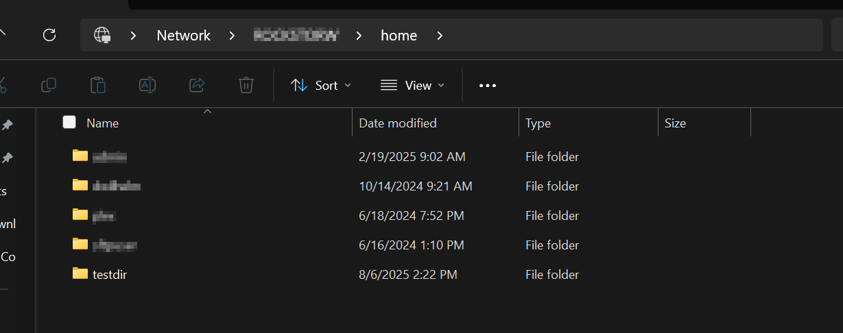

For testing I also created a test directory testdir. Now, under the above setting it will pretty much behave like a normally created Samba export in Rockstor. Even if one doesn’t have write access it will still be listed and one can enter the directory.
Now, when changing the testdir to permision 700 using
chmod 700 ./testdir
only the owner (in this test case root) can interact with the folder. However it is still being listed (as you observed, too).

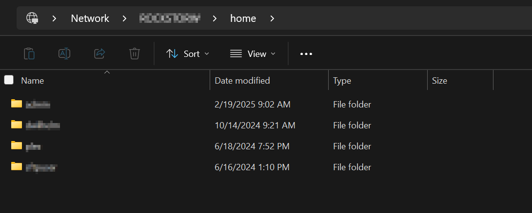

When I flip the share-level parameter to yes:
    hide unreadable = yes
and restart the samba service (systemctl restart smb) then a refresh of the home samba export will now show only the folders that don’t have the access rights of 700 (I’m obviously not using root to access the samba share but some other user).
So, I think, in order to fulfill your requirement, you need to change all home sub-directories representing users to 700 AND activate the above parameter hide unreadable = yes for the home samba share.
