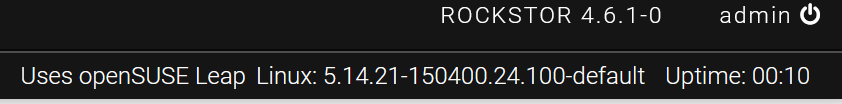

I updated Leap tp 15.6 with no issues (thanks for Distribution update from 15.5 to 15.6 — Rockstor documentation ).
I expected the “up arrow” to appear after reboot but it isn’t there.

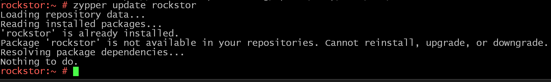

zypper refresh and zypper lu say that nothing is available.
Perhaps I missed a step. Am I pointing at the right repositories?

3 | Rockstor-Stable | Rockstor-Stable | No | ---- | ---- | http://a0c98c86-8efe-d511-ac28-00248cbf09ea@updates.rockstor.com:8999/rockstor-stable/leap/15.6?credentials=/etc/zypp/credentials.d/Rockstor-Stable&auth=basic

Followup/additional info:
And ignore most of that…
I switched to the Testing channel and, lo & behold, 5.1.0 is available! Sorry - I should have thought about that immediately. I’ll do that tomorrow or Tuesday, when the toddler grandchildren aren’t here and interrupting every 30 seconds.

It ran pretty smoothly. From the web UI, nothing was updated after the 5 minute timeout expired; it was still at 4.6.1
zypper update rockstor ran to successful completion. At that point, the web UI would not load (bad gateway error from nginx) but a reboot seems to have taken care of it. All rockons and samba shares are up and running as expected.
