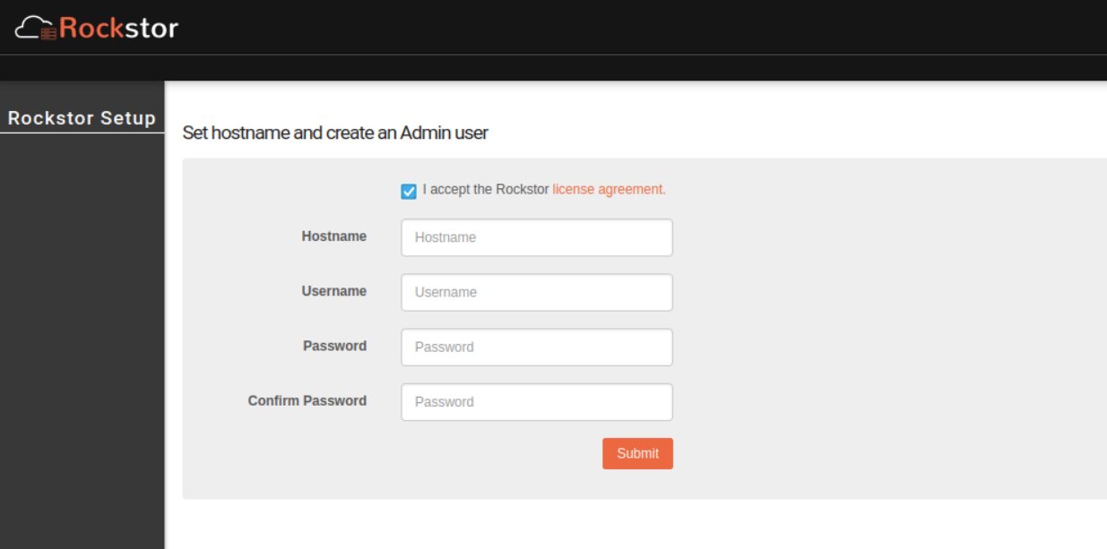

Since in my case, it installed an additional 100 packages, so I planned for a reboot. Thus, dropping the --now option
systemctl enable rockstor-bootstrap
Reboot.
systemctl status rockstor
● rockstor.service - Rockstor startup script
     Loaded: loaded (/usr/lib/systemd/system/rockstor.service; disabled; preset: disabled)
     Active: active (running) since Fri 2025-05-02 10:53:58 PDT; 6s ago

And https://localhost yields:
After the basic setup and selecting the Test channel, another reboot. Hostname is set and Rockstor comes up without relevant error messages (there are some because the data collector is looking for a pool that’s not set up yet).
On another VM I updated an existing Rockstor 5.0.15-0 on TW instance with the latest TW package updates. Following a reboot I also did not run into any issue, but that was also not an install from scratch.
@kanwarplaha, could you share a few more details on the system you’re running your install on? Not sure it will be related, but to be thorough …
