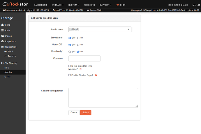

Hello,
after upgrading to v4.5.4-0 my SMB Shares (working perfectly fine since going to V4) stopped being accessible.
I tried to find the cause myself, but I’m not seeing a for me understandable “real” error message in the logs…
Also i tried it with another, newly created user. Stopped samba Service, deleted and added the samba-shares/exports and also tried it with different settings of Admin-Users for the share/export (none, Main User, Mark2 (new user)) and with different file owner settings in the share itself (owner root, group users; owner Mark2, group users).
Here is what I get
(Saying Access denied)

SMB Configuration:
I have to say, that I’m running stable kernel backports as described in the rockstor docs. So I’m not really sure if it’s related to the latest rockstor update or the latest kernel update.
Any help is appreciated ![]()
