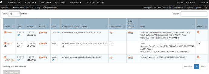

Pools (Note that WD8TbExt is my backup pool; a USB-attached drive.)

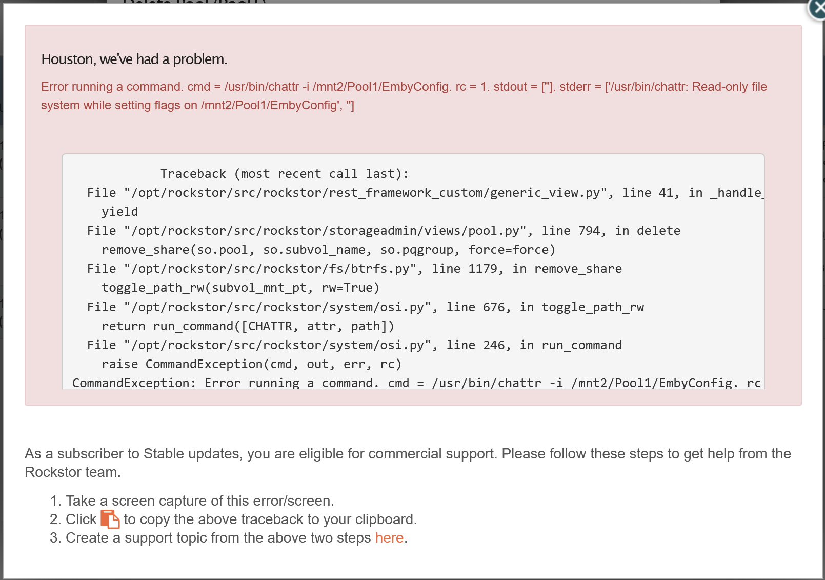

I don’t remember whether having active samba share definitions prevents you from deleting the pool, but I think it does, because when you try to delete a share that has a Samba export Rockstor stops you from doing that.
ah yes, because you the file system is mounted as read-only, you can’t make any changes (including a pool deletion). And since that’s your fundamental problem, we don’t need to discuss on how you can mount it in degraded or just read/write mode ..
I think the wipefs is probably the option you have to go with at this point. Not sure, but you might have to unmount the pool as well before the wipefs (but you’ll find out).
