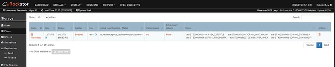

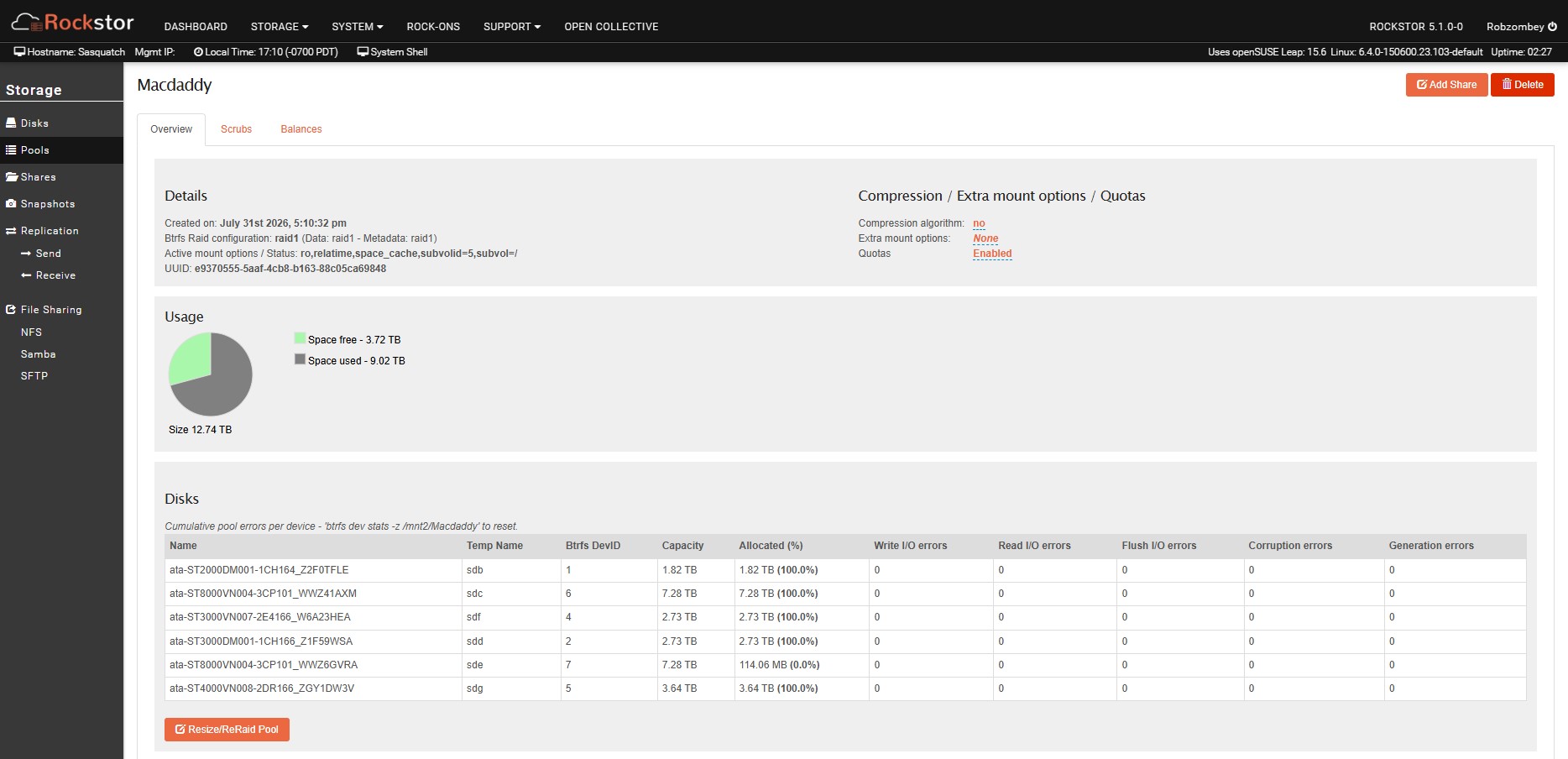

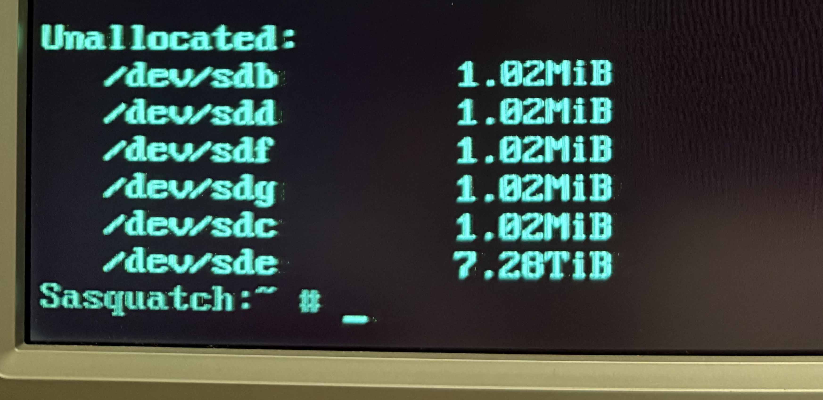

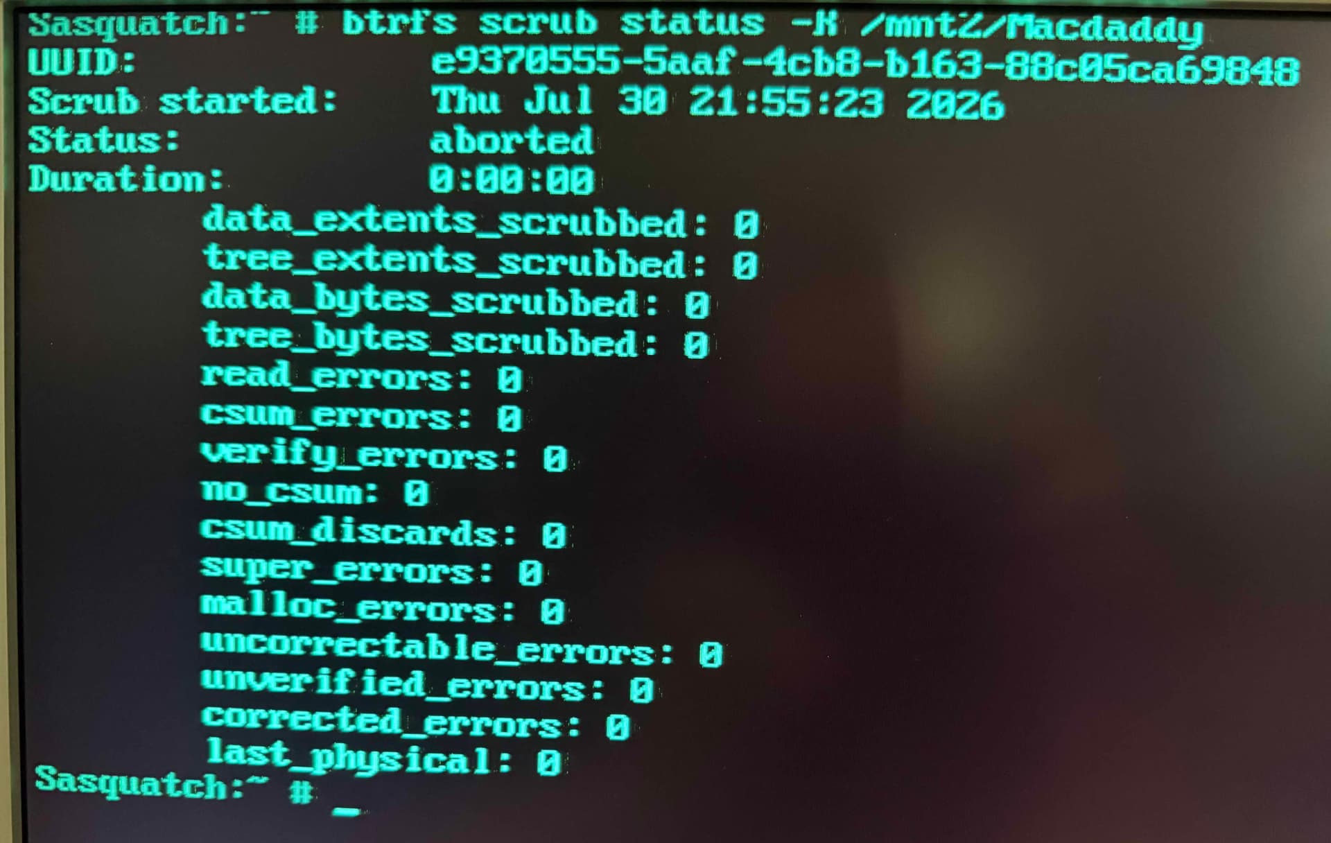

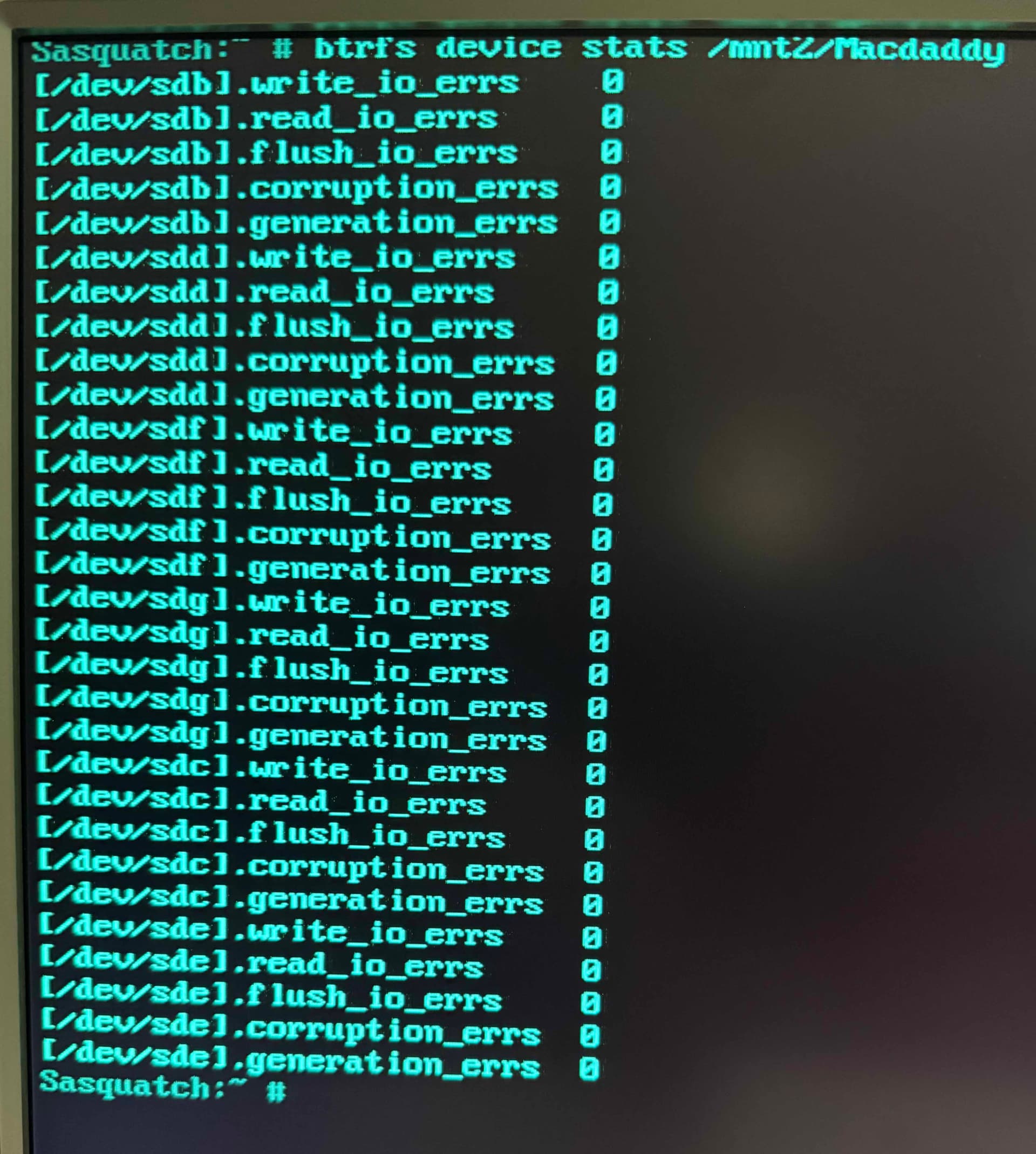

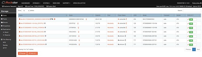

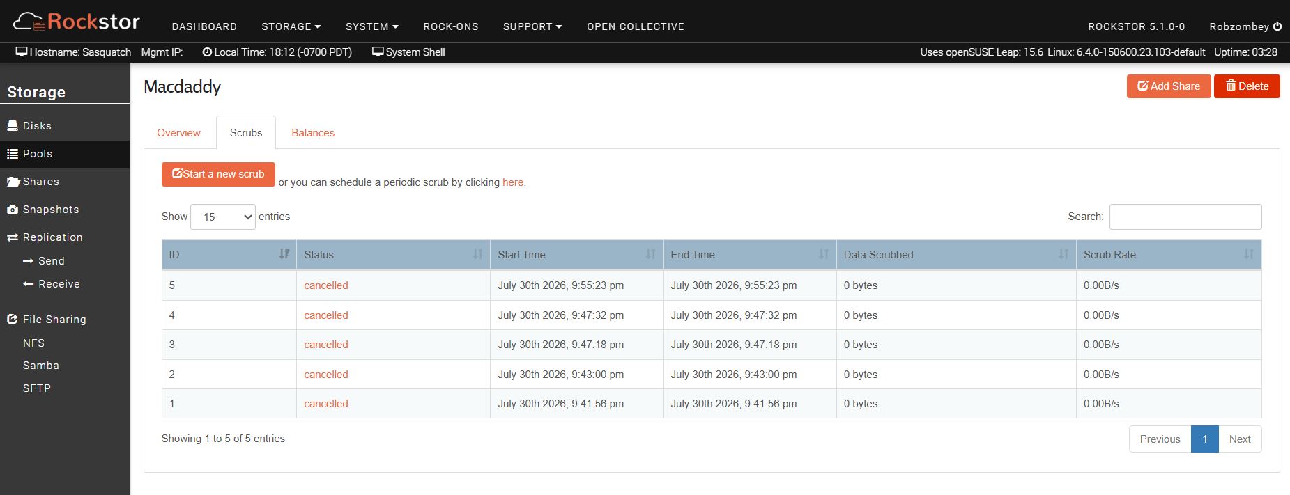

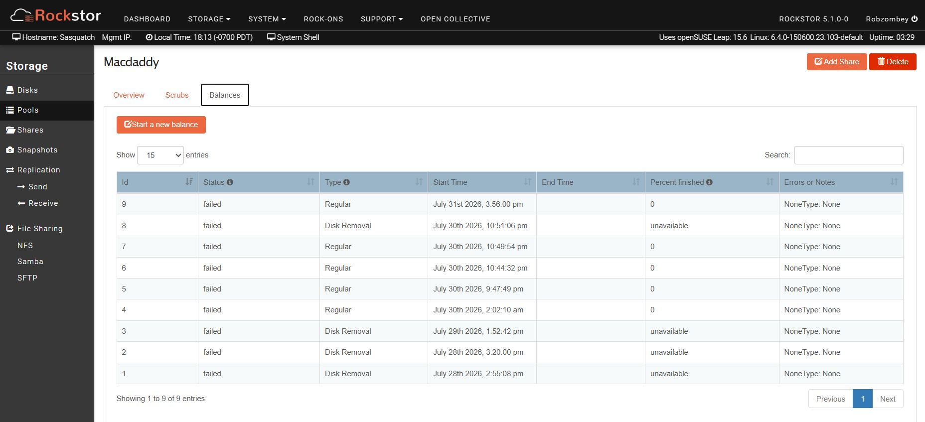

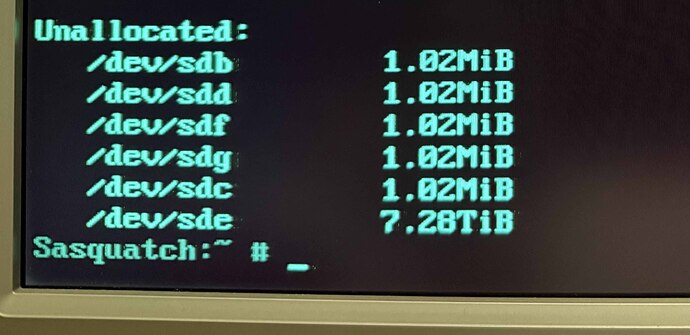

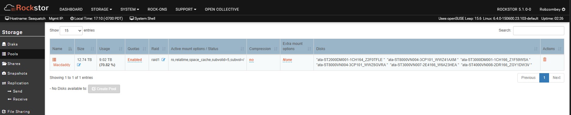

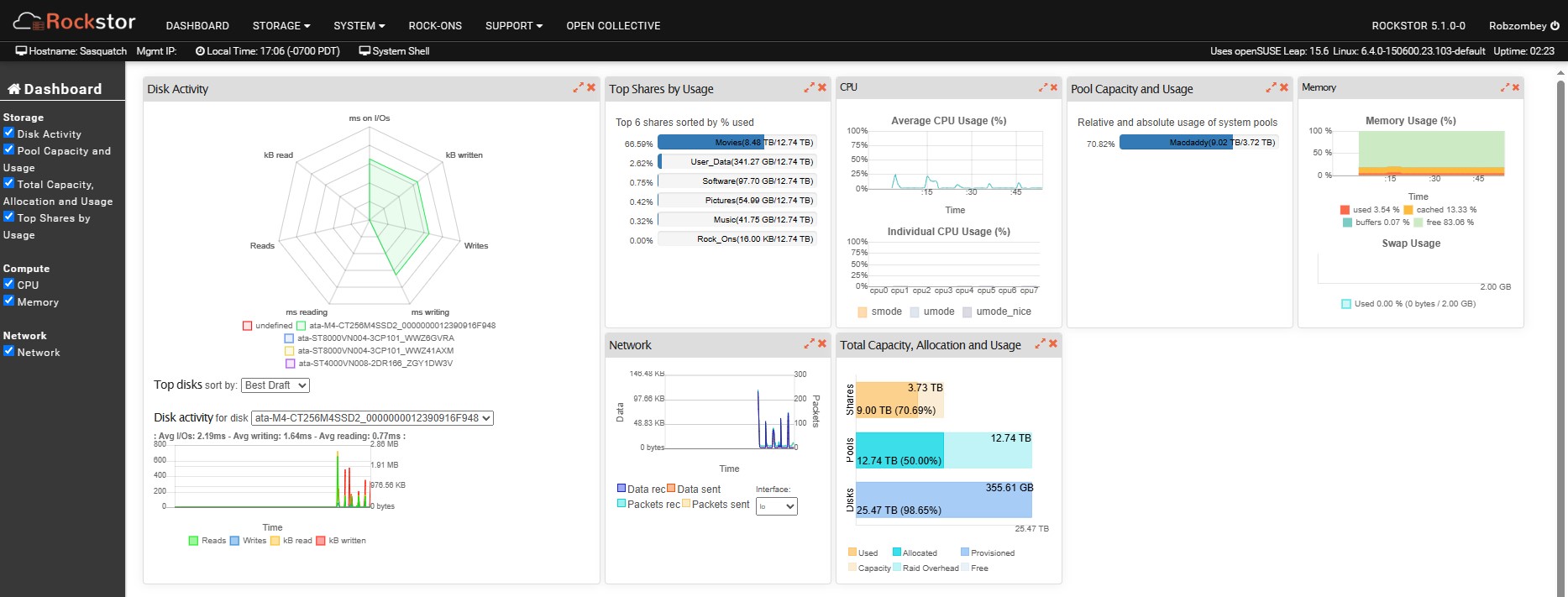

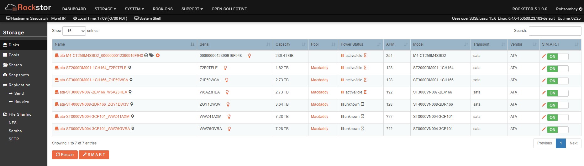

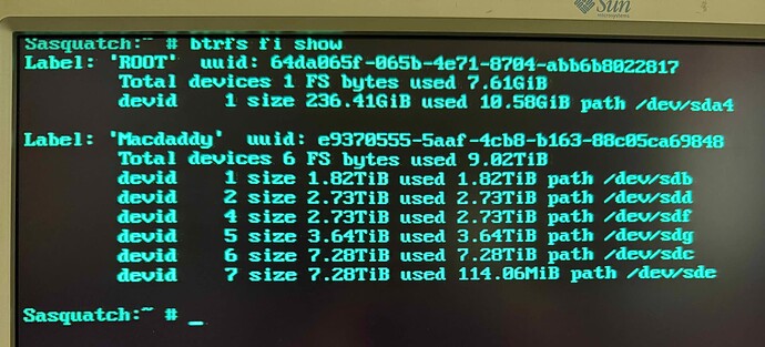

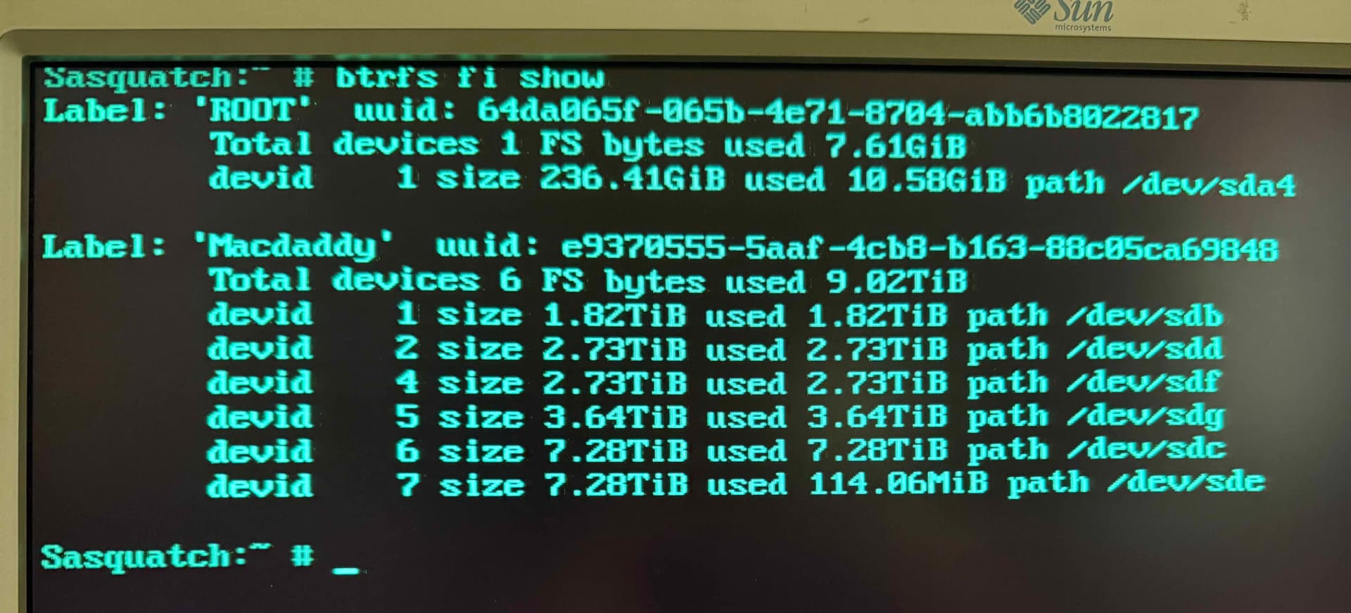

First and foremost, I am not a guru, so it might take some generic terms to complete this request. I added a new 8Tb drive to my Pool to increase capacity as it was running out of room. After adding the drive, I updated the Rockstor Install from Rockstor-Leap15.6-generic.x86_64-5.0.9-0 to the latest Rockstor-Leap15.6-generic.x86_64-5.1.0-0 without noticing any errors with the new disk install. But after configuring the WebUI, adding the Pool and Shares, I found that the Pool had been changed to read-only. I still have access to all of the data but cannot change or add any data in the Pool. Any actions to remove the new disk or re-size, balance or scrub is met with the same error, basically it says that there is no space left. In looking at the Pool Info in the WebUI, the new 8Tb (/sde) disk is basically showing as 0.0% allocated. So I am assuming something went wrong with adding it initially. The Remove Disk and Re-Raid did not work but also did not show any error windows.
I am attaching the WebUI and CLI screenshots to the case. I have the Rockstor Logs and Dmesg Log as well if needed, just need to know how to attach them here.
Is there anything I can do to remove the disk or force a re-balance to get the disk working correctly in the Pool?

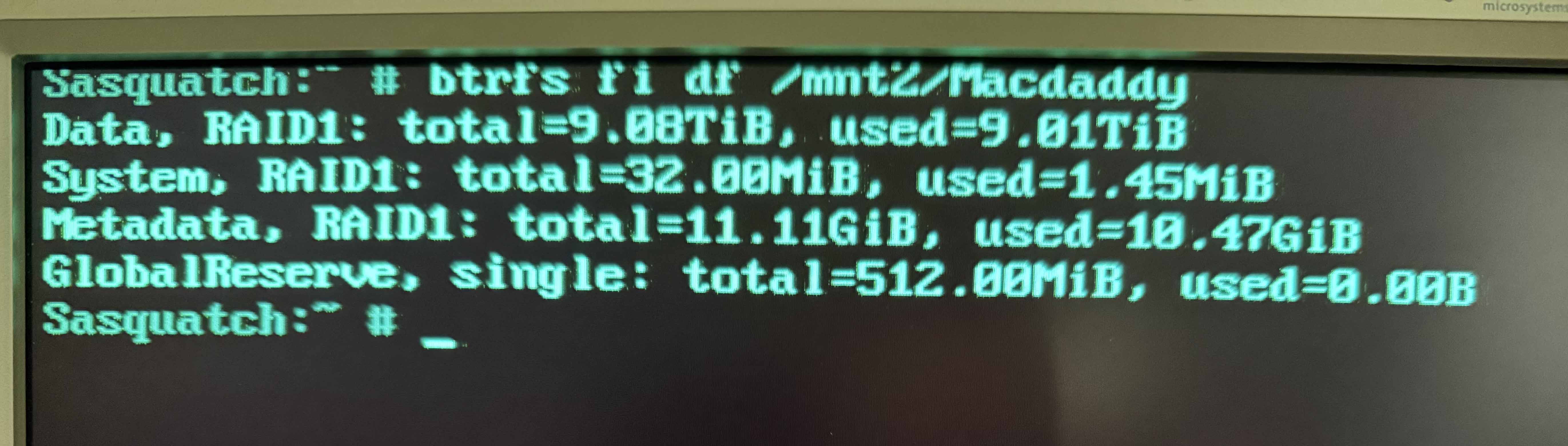

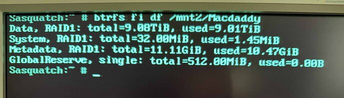

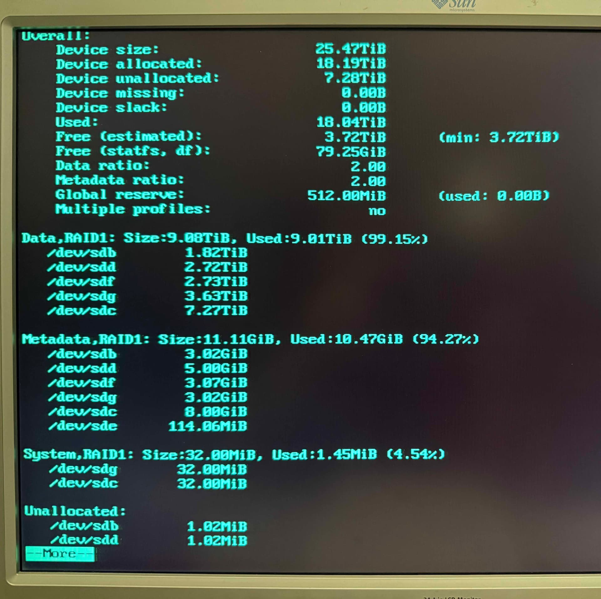

If I’m not mistaken, it seems that the devices are pretty much full, which would explain why it was forced into read-only mode by the kernel. I am surprised that you were able to add the device in that mode (but maybe it just went into that right after you added it).

First, Thank You for responding to my emergency. I know that you are correct about the disks being full, that was most likely my first mistake by not watching how much space I had before performing anything.

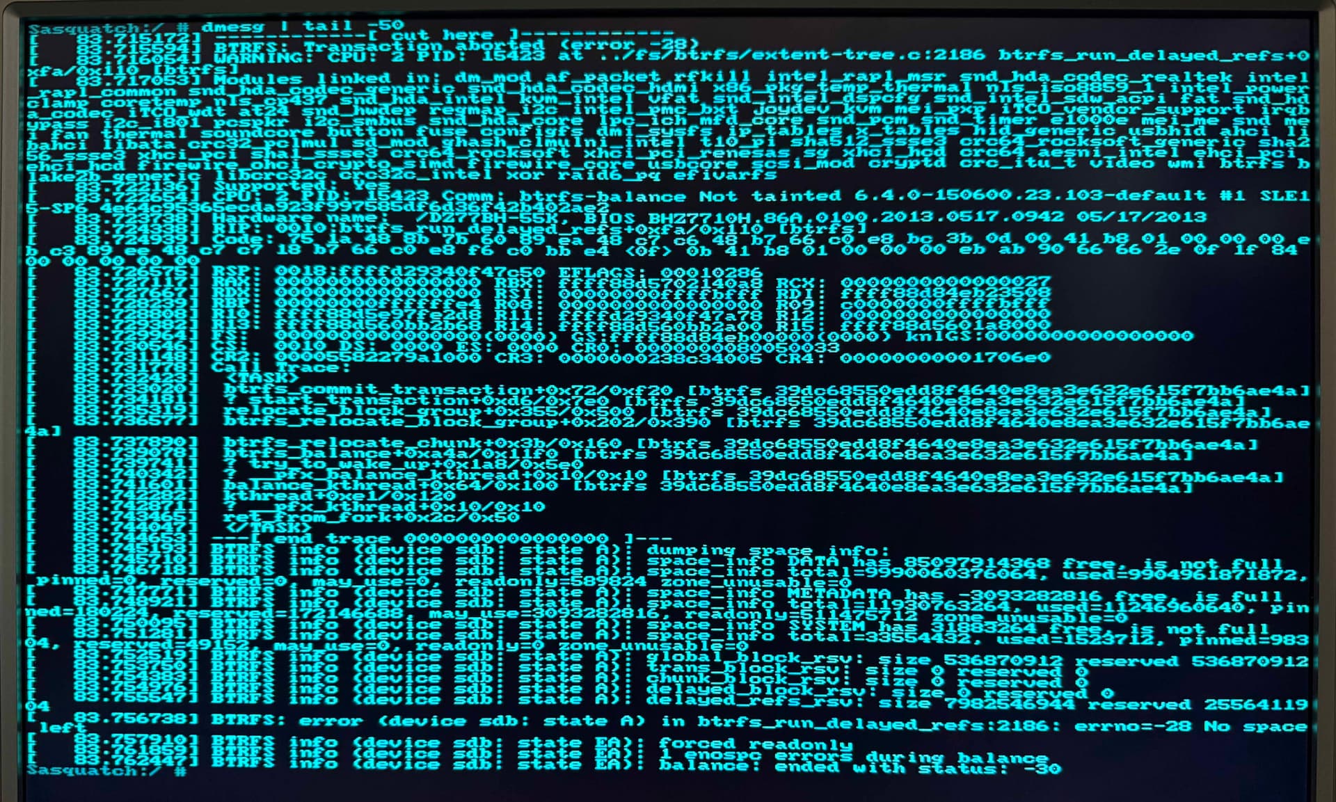

Here is the last 50 lines of the dmesg log:
If I am reading this output correctly, it looks like the Metadata has no room to save anymore data.
