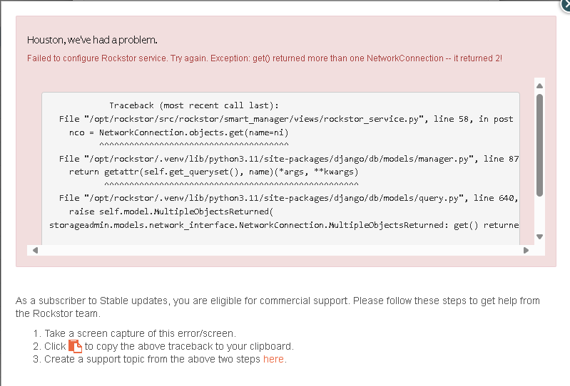

Failed to configure Rockstor service. Try again. Exception: get() returned more than one NetworkConnection -- it returned 2!
Cannot set Rockstor interface in “System, Services, Rockstor”
Used the dropdown to select the static interface used for the Web UI. When I click on submit, it returns the error shown.

I know this is an old post but I am getting the same error with version 5.1.0-0:
Updating rockstor service
Went to services and clicked on wrench to open settings. Clicked wired connection with updated management ip address. Clicked on submit.
Traceback (most recent call last): File "/opt/rockstor/src/rockstor/smart_manager/views/rockstor_service.py", line 58, in post nco = NetworkConnection.objects.get(name=ni) ^^^^^^^^^^^^^^^^^^^^^^^^^^^^^^^^^^^^^^ File "/opt/rockstor/.venv/lib/python3.11/site-packages/django/db/models/manager.py", line 87, in manager_method return getattr(self.get_queryset(), name)(*args, **kwargs) ^^^^^^^^^^^^^^^^^^^^^^^^^^^^^^^^^^^^^^^^^^^^^^^^^^^ File "/opt/rockstor/.venv/lib/python3.11/site-packages/django/db/models/query.py", line 640, in get raise self.model.MultipleObjectsReturned( storageadmin.models.network_interface.NetworkConnection.MultipleObjectsReturned: get() returned more than one NetworkConnection -- it returned 2!

looking at your screenshot though I see two “Wired connection 1” entries … one with IP and one without, in addition to your “Wired connection 2”
I will give that a shot and get back to you. I noticed the extra wired connection 1 myself. Based on the initial poster’s remarks, I assumed that was there from initial setup as the link in phillxnet’s post mention that and also that it was fixed in 5.0.9-0. Give me a few and I will test removal of the secondary interface and post back.

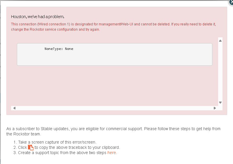

So I gave that a try but no luck. I did go into network settings through the UI and tried to delete the second “Wired connection 1” entry and I got the following error:

OK. So I shut down the VM and removed the interface. Booted it up and the two wired connection 1 entries were still there and unable to be removed. Shut back down and re-added the interface. It showed up as a new entry “wired connection 3”. Still have the other two and unable to delete but I was able to successfully update the rockstor service to reflect entry3 instead of entry 1 and after that, I was able to successfully delete those two entries:
So the trick here, as I see it, is to make sure the connection you are working with is NOT the management interface the rockstor interface is configured to connect to. :grinning:
The stack trace and the Nonetype error are, in my opinion, red herrings leading down an incorrect path by not stating there is some type of lock on the interface when configured as management interface.
