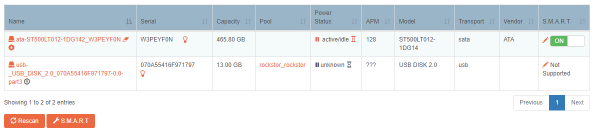

Also a picture of the Disks page might also help, along with the version of Rockstor you are using.

Screenshot of drives page:
The other drive that was paired with this one no longer exists.
I’m only interested in recovering the data that is/was on this drive. If that’s not possible, it’s not the end of the world. Basically, tell me if I’m wasting my time with this.
I’m not sure on the version of Rockstor but the iso was downloading and freshly installed within the last week.
