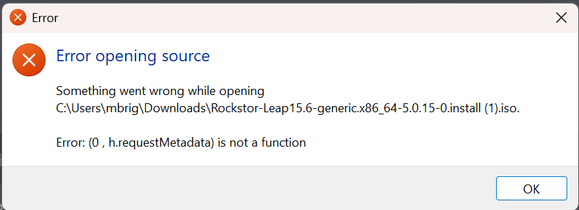

Having got a Super Micro X10 SLM -LN4F Motherboard to post with a replacement CPU Xeon E3 1285L V4, I intended to reinstall a fresh version of Rockstor, visited the Download page and saved the latest Generic Version X86_64-5.0.15-0.install to the downloads folder, deployed balenaEtcher and received this message.
Redownloaded the ISO file repeated the balenaEtcher process and received the same error.
Thinking that the balenaEtcher app had been corrupted I downloaded bE once more and retried, resulting with the same error.
Anybody any ideas on a work around
Thanks
According to the forums on bE it is a problem with many OS especially W11 which is what I am using.

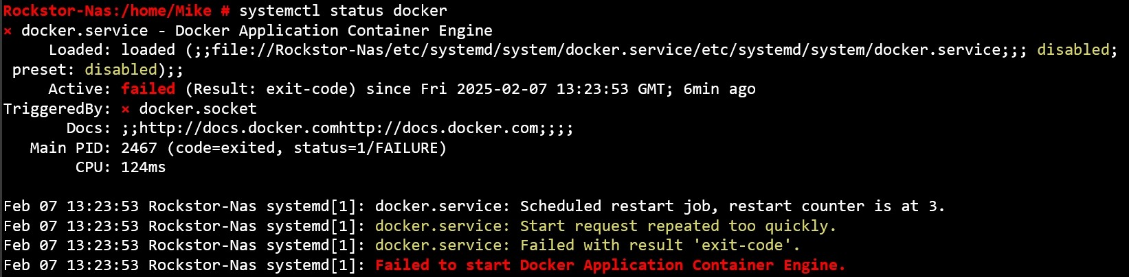

opened the command line and used the commands suggested by @Hoverdam resulting in.
It would appear that docker has not loaded hence the reason the Rockons are not functioning.

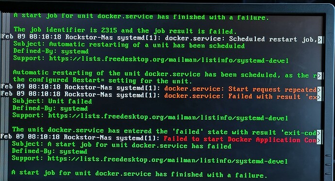

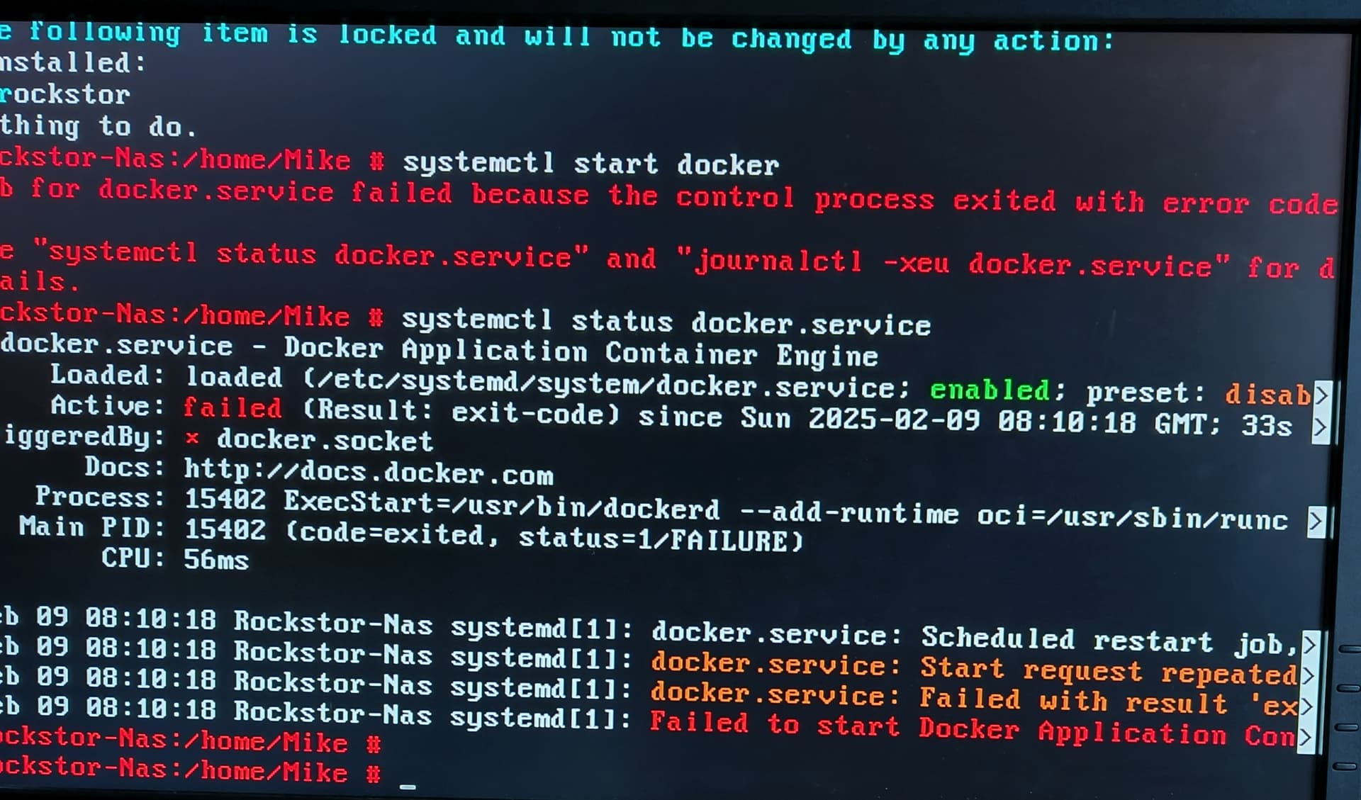

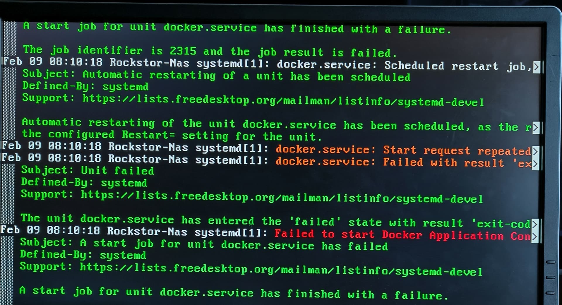

The returned Script when inputting “systemctl start docker”
After a reboot the start docker command returned
Now at a complete Loss as to what next??
