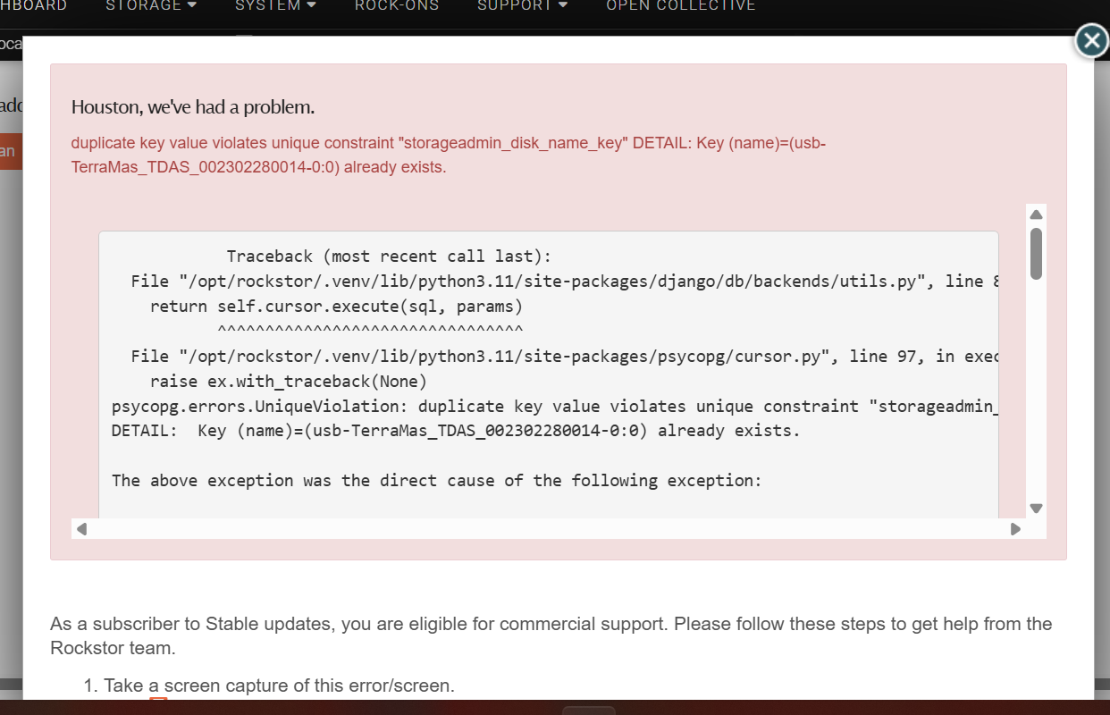

Recent reinstall due to error, now I can't access the same drives that I previously used due to a key contraint on storageadmin_disk_name_key
All of a sudden I was getting multiple errors on my previous install of Rockstor with dependancies that I could not get to start running, so I have reinstalled Rockstor
Once it was back up and I got into the WebUI I re-attached the USB drives I had before and have not wiped, and when scanning for disks I get the following error:
“duplicate key value violates unique constraint “storageadmin_disk_name_key” DETAIL: Key (name)=(usb-TerraMas_TDAS_002302280014-0:0) already exists.”
I do sort of expect these disk names to exist, as they are the same as the ones I have previously used.

Resintall new instance of Rockstor, without the disks attached
Start up Rockstor
Login to webUI
Go to disks, and scan
Get error
File “/opt/rockstor/.venv/lib/python3.11/site-packages/psycopg/cursor.py”, line 97, in execute
raise ex.with_traceback(None)
django.db.utils.IntegrityError: duplicate key value violates unique constraint “storageadmin_disk_name_key”
[21/Jul/2026 19:30:02] ERROR [smart_manager.data_collector:1017] Failed to update disk state.. exception: 500 Server Error: Internal Server Error for url: http://127.0.0.1:8000/api/disks/scan
digging a bit more, it seems to be the usb enclosure. However, this exact setup has worked previously. Each drive does send its serial number, so they can be seen as unique.
How could this setup have worked previously?
