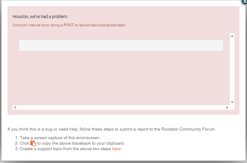

Rockon service wont load
HI all.
Hope this is something with a quick fix, as I dont have the time here before Christmas for deep troubleshooting :slight_smile:
Yesterday we had a few power outages, and as a result the Rock on service wont load. And therefore Plex (which is the only Rockon I use) doesnt work…
I dont get much in the way off error messages.
When trying to start the Rock-On service i get this.
And each time I try to start the service I get this in dmesg output:
audit: type=1400 audit(1766218373.747:10): apparmor=“STATUS” operation=“profile_replace” info=“same as current profile, skipping” profile=“unconfined” name=“docker-default” pid=6839 comm=“apparmor_parser”
What could be wrong, and is there an easy way to get the rockon service up and running again?
I guess some config file has been corrupted or has gone missing.
A scrub of the system drive gave no errors.
