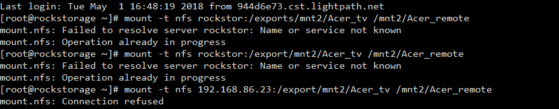

First thing I did was create an nfs share for an existing folder on machine 2 “rockstor”
Next I used the rirst line example mkdir -p /mnt/rockstor2/downloads
actual used on machine 1 host “rockstorage” mkdir -p /mnt2/Acer_remote And the folder was correctly created in rocstor
Next I attempted to recreate the second line mount -t nfs rockstor2.box:/exports/downloads /mnt/rockstor2/downloads
Actual attempts
mount -t nfs rockstor:/exports/mnt2/Acer_tv /mnt2/Acer_remote
mount -t nfs rockstor:/export/mnt2/Acer_tv /mnt2/Acer_remote
mount -t nfs 192.168.86.23:/export/mnt2/Acer_tv /mnt2/Acer_remote
I am quite sure that I am just missing something very simple but I can’t seem to get the share to mount.

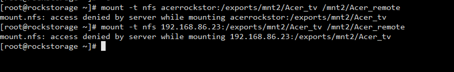

Here are the responses that I get when i try to run the lines on machine 1 “rockstorage”
Thanks
Chas

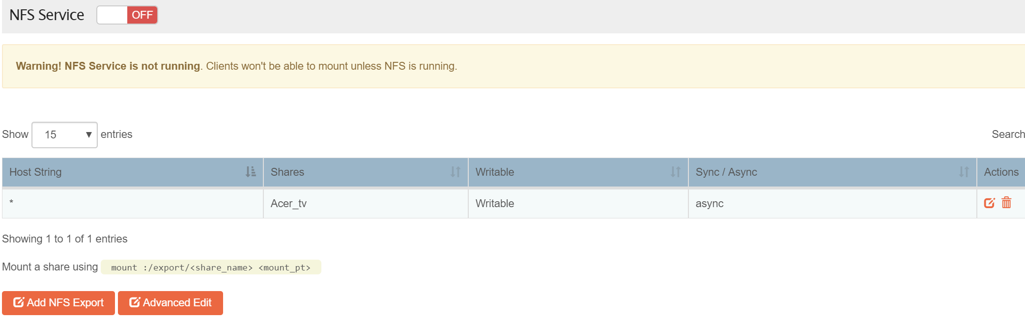

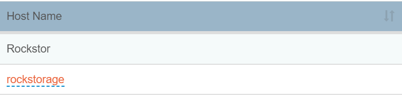

Hi @kysdaddy,
Note that on Machine 2 you have the NFS service OFF (per your screenshot), this explains the connection refused on Machine 1 when accessing by IP.
When accessing by hostname, it appears that Machien 1 doesn’t know the hostname ‘rockstor’.

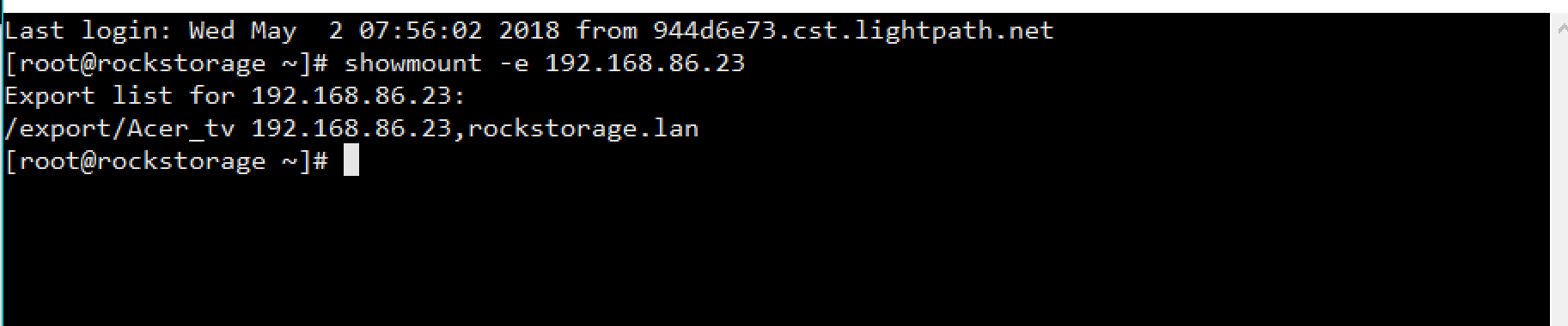

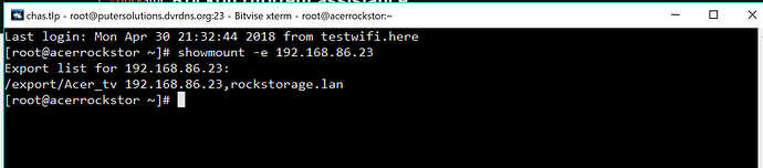

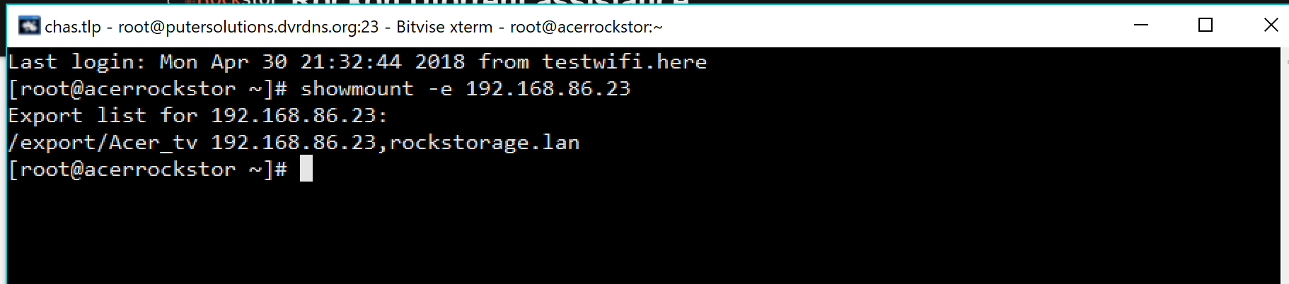

Could you provide the output of:
showmount -e 192.168.86.23
on both systems?
machine 2
Machine 1
Thx
Hello, does this help?
@kysdaddy,
Unfortunately, it provides no insight into your issue.

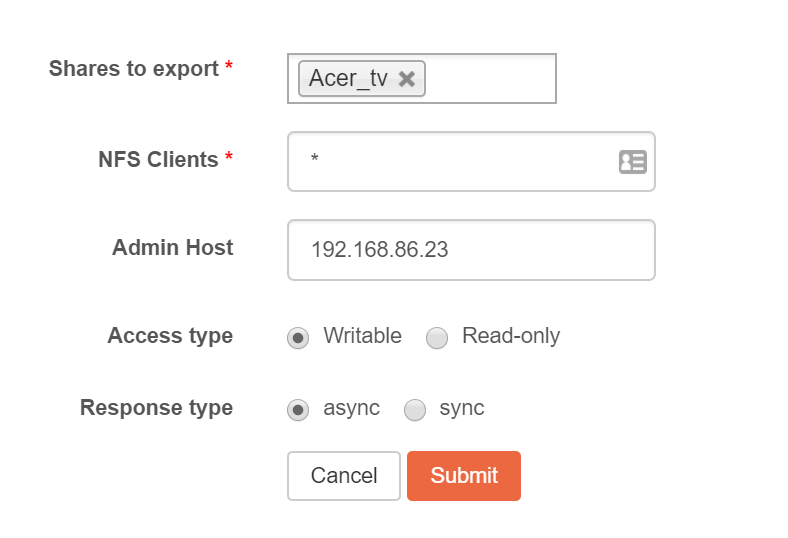

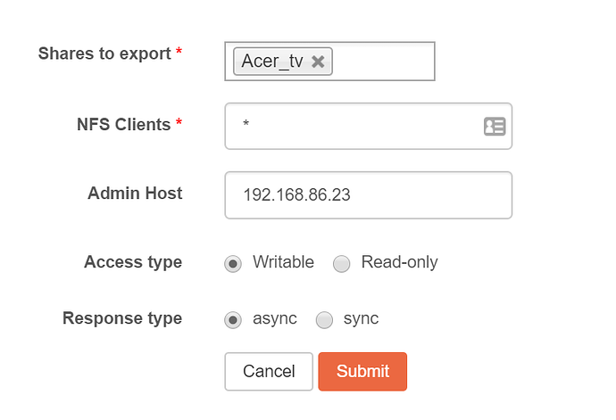

Could you please have a look at Storage -> File Sharing -> NFS -> Advanced Edit, and copy/paste the contents of Enter manual export entries below.?
Also, try changing the export NFS clients list to a network CIDR rather than wildcard, such as 192.168.0.0/16 to see if that helps.

the issue was entirely self-created I was using mount -t nfs 192.168.86.23:/export/mnt2/Acer_tv /mnt2/Acer_remote
And if I would have followed your original directions more precisely and used mount -t nfs 192.168.86.23:/export/Acer_tv /mnt2/Acer_remote
It would have worked days ago
Sorry about that and thanks again.
