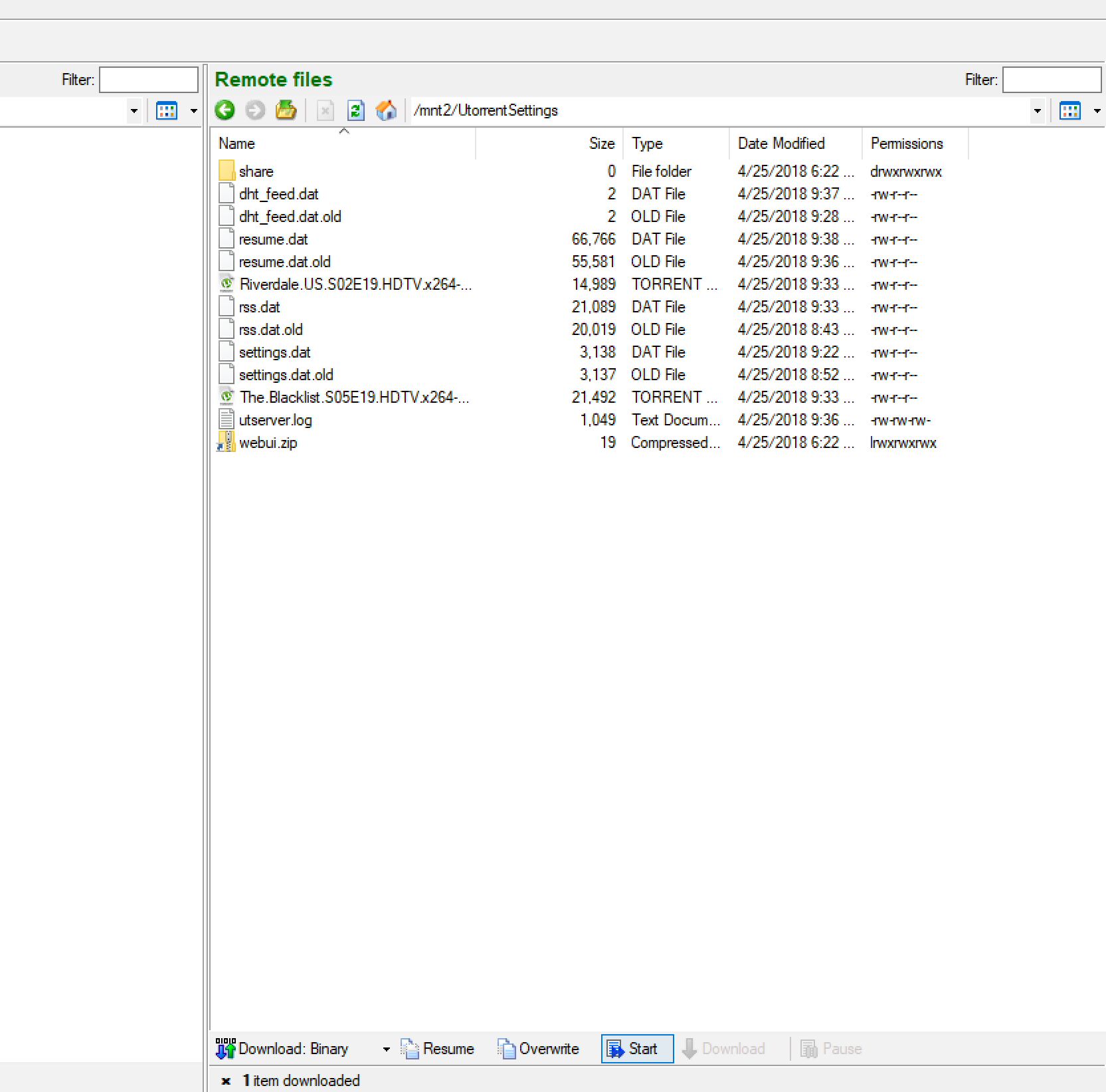

OK I found where it is saving the files. The files are being saved in /mnt2/UtorrentSettings
is that correct? how can I move or redirect those files?

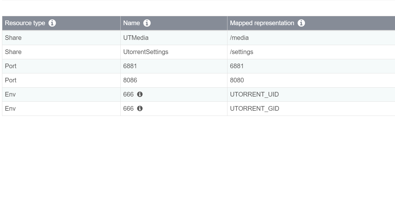

When you installed the Rockon, you were asked to provide two volumes to be mapped.
/media     - Directory for your downloaded media
/settings  - Holds all the utorrent settings files and databases
In this case, during the installation, you (hopefully) selected the /media location as /mnt2/Rock_TV
If you did this, then inside the utorrent configuration, you must select the path that it has been mapped to - /media and this will resolve the issue.
If you did not do this during the initial install, then your easiest option will be to uninstall and re-install the Rockon with the correct settings.
Thanks for responding, the odd part of this is that my files are being saved in the settings share and the data/media share isn’t being used at all.
I uninstalled and tried it again and the same thing happens. I created two shares UTMedia and UtorrentSettings. UTMedia is empty and UtorrentSettings has settings and the downloaded files.

Wait a minute it saving the torrents in settings but I still don’t see the files.

So you’ve configured the utorrent rockon with the share labelled UTMedia to /media

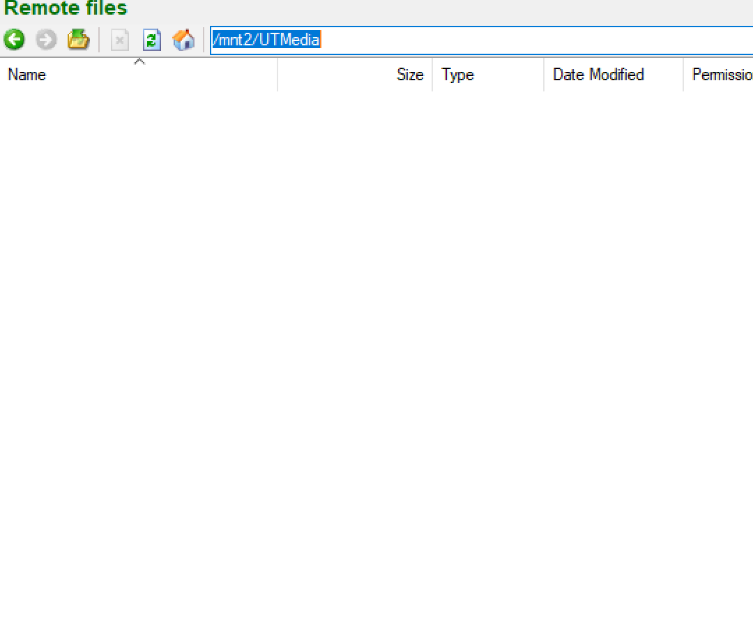

Assuming your utorrent client is correctly configured to download into /media that means your files should be available in /mnt2/UTMedia (The share mapped to /media).
If this is the case, I suggest browsing to /mnt2/UTMedia and having a look.
If your utorrent client is not configured to download into /media, then the files will be stored internally in the Docker image, which is not ideal, and requires some fairly advanced knowledge to get it.
If you want the downloads going to /mnt2/Rock_TV, you need to reinstall utorrent appropriately to use the Rock_TV share instead

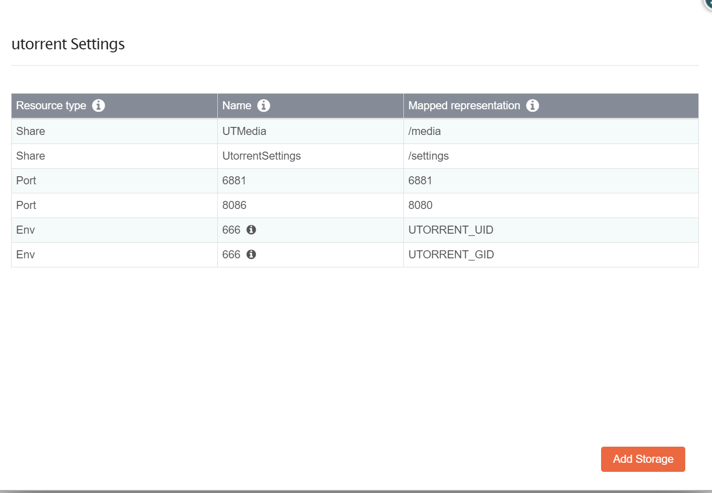

you can see in the photos that I have /UTMedia mapped to /Media so it seems correct yes?
Sorry for all the pictures I just want to be sure that I am being clear
Install settings

Even though I don’t have any experience with this Rock-on, it appears to me that, based on your Rock-on installation screenshot, you have set the UTMedia share defined in Rockstor as the /media folder for the Rock-on.
As a result, in the UT webUI, you should be able to set the folder /media as the download directory. To see (and access) these files from “outside” of the Rock-on, you would simply need to go to /mnt2/UTMedia.

Thanks that’s my understanding as well but unfortunately as you can see in the photos, the files are not showing up where I have mapped them to be. I am at a loss as to where they might be going.
The actual torrent is being saved in settings, until I delete it using the UT UI.
It seems that the actual media files are being saved on my system disk rather than where they are supposed to be . My system disk had grown from 3.07 gb to 28 gb before I uninstalled Utorrent.
