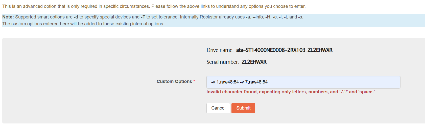

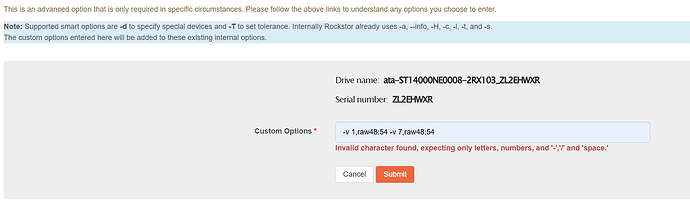

Seagate needs smart params -v 1,raw48:54 -v 7,raw48:54 that can’t be added due to the colon, error count is now wrong.

Can you give a bit more details on how you are trying to add these (WebUI, command line) and which version of Rockstor you’re running?
I can now see the issue:
I think the custom option here is that you can only use option -a before setting the value formats that you did. However, it really doesn’t matter at this time, because of the field check that doesn’t allow the : to be entered in the WebUI, regardless of whether the parameters are “allowed” or not through this field. I’m afraid, I have not used that before to set additional SMART information, so I’m of no help.
What I did try is running this on the command line via:
smartctl /dev/sg2 -x -v 1,raw48:54,Read_Error_Rate -v 7,raw48:54,Seek_Error_Rate -v 18,raw48,Head_Health -v 200,raw48,Pressure_Limit -v 240,msec24hour32
