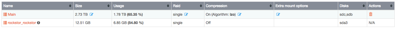

But the GUI now indicates the pool as single with no redundancy
