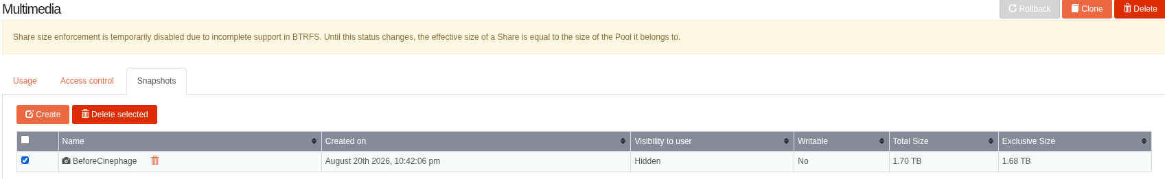

-something- decided to remove just about everything from one of my shares (I haven’t figured out what yet). Luckily I have a snapshot from a few days before, so I thought I was saved. However, I cannot figure out how to restore the snapshot.
I have removed the SAMBA and NFS shares for the share and also disabled both services. I then tried to select the snapshot and “Rollback”,
However, the “Rollback” button stays greyed out, so I cannot use it. In the documentation it mentions creating a clone, which I tried, however, the clone is the exact same size as the current share, not the size of the snapshot.
I don’t know how to recover my snapshot now.
Snapshot, size 1.7TB, “Rollback” button greyed out
Clone made from the snapshot, but has the same size as the current version of the share

@stitch10925 Re:
How did you go about making a clone from the snapshot? If it was via the clone button in your first screen shot while viewing the snapshots tab for the Share Multimedia; then that is a clone of the Multimedia Share in it’s latest form, i.e. not what you are after. The tick indicated against the snapshot causes the RED “Delete snapshot” button to appear. It does not enable this snapshot as a Clone target. But yes this is a UI confusion for sure. We plan to re-do all of the Web-UI as we move past the next Stable release.

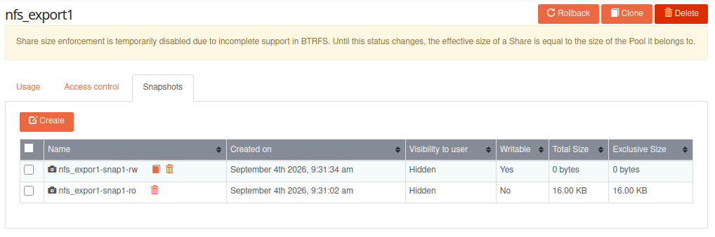

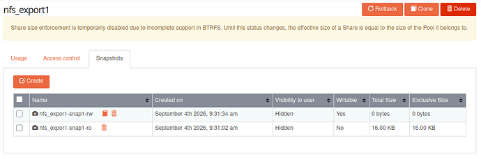

From a quick experiment I can confirm that, wright or wrong, readonly snapshots (default) do not offer rollback targets:
In the above toy example the Rollback button only appeared after I added the second rw snapshot, it was greyed out after only adding the ro (default) snapshot. Also we see an additional icon next to the rw snapshot with the mouse-over text of “Clone snapshot”.

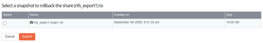

After the above example the big orange Rollback button at the top of the screen presented the following page:
So Rollback is offered for read-write snapshots, but not read-only snapshots.
