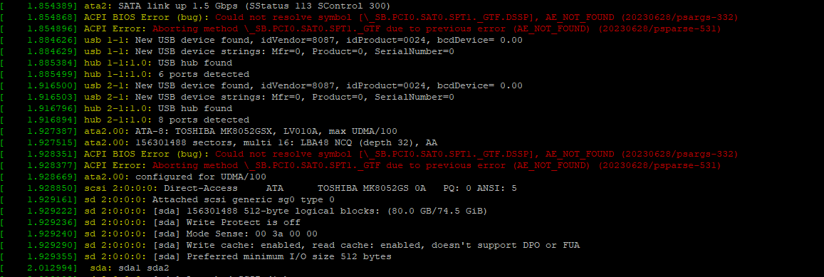

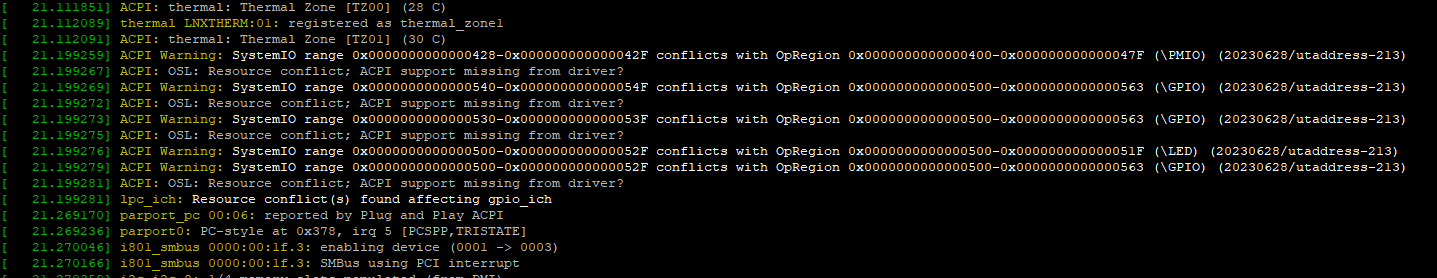

Just wanted to update this. Today I installed vanilla openSUSE and it installed fine. It does give me some errors regarding the BIOS, but reading about it most things said it should be able to be ignored. I have then installed Rockstor by adding the repositories and installing using the guide and everything seems to be working no worries again. The drives were recognised by SAS openSUSE at installation and are recognised by Rockstor now. They were not recognised by Rockstor during the install.
For reference I have included the errors and warnings I still get in dmesg, I am assuming these would have something to do with why Rockstor Leap wasn’t installing using the installer.

I believe, the errors you see during the boot (I get a few similar ones without further consequences) are related to how the BIOS has implemented the power management (ACPI), which conflicts with the standard. This is not unusual apparently.
Theoretically, that should not cause your previous installation issues, but … who knows.
