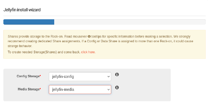

I did a test install, and it seems to work:
WebUI port must be 8096 since this container is running using the net=host option

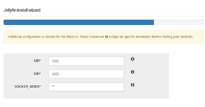

assuming the transcoding of an Intel processor should be active:
no Docker mods:
summary:
After install accessing jellyfin page:
The only difference between my and your summary, aside the missing config share is the VAAPI device, though I don’t think that will fundamentally sabotage jellyfin from coming up.
